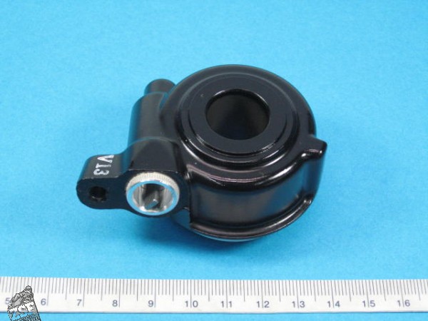

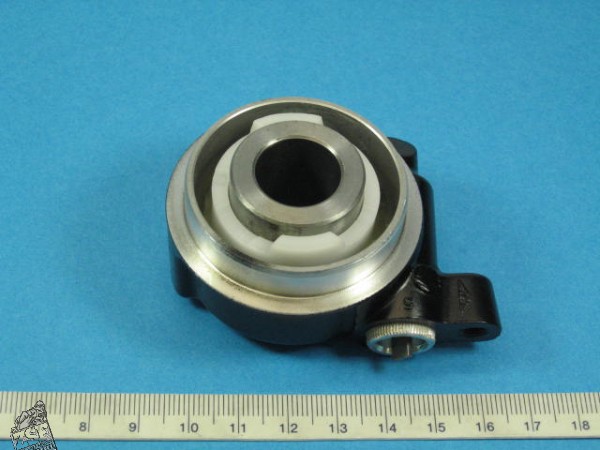

| martinss | | 17. Jun 2011, 15:22 | #11365 |
| Turpinu mekleet spido mehanismu 17" ratiem... Troses aukshdalja maneejam der arii no africa twin, bet africa twin troses lejas dalja ir tada pati kaa baram citu hondu ar 17 ratiem (pats mehanisms africa twin gan ir cits kaa hondam sarakstaa zemaak, vismaz peec part# numuriem nesakriit):
CBR1000F 1000 HURRICANE '87 US
CBR600F CBR '87 US
NT650 HAWK GT 1988 US
PC800 PACIFIC COAST 1989 US
CBR900RR CBR 1993 US
VF750C MAGNA 750C 1994 US
VF750C MAGNA 750C 1998 US
CBR1000FH 1987 AR
CBR1000FH HURRICANE 1987 CM
CBR1000FH 1987 E
CBR1000FH 1987 ED
CBR1000FH 1987 F/YB
CBR1000FH 1987 FI
CBR1000FH 1987 G
CBR1000FH 1987 IT
CBR1000FH 1987 ND
CBR1000FH 1987 SD
CBR1000FH 1987 SP
CBR1000FH 1987 SW
CBR1000FH 1987 U
CBR1000FJ 1988 AR
CBR1000FJ HURRICANE 1988 CM
CBR1000FJ 1988 E
CBR1000FJ 1988 ED
CBR1000FJ 1988 F/YB
CBR1000FJ 1988 FI
CBR1000FJ 1988 G
CBR1000FJ 1988 IT
CBR1000FJ 1988 MX
CBR1000FJ 1988 N
CBR1000FJ 1988 SD
CBR1000FJ 1988 SP
CBR1000FJ 1988 SW
CBR1000FM 1991 MX
CBR500FH 1987 AR
CBR500FJ 1987 AR
CBR500FK 1989 AR
CBR500FK 1989 MX
CBR500FL 1990 AR
CBR500FM 1991 AR
CBR600FH HURRICANE 1987 CM/MKH
CBR600FH 1987 E/MKH
CBR600FH 1987 ED/KPH
CBR600FH 1987 F/KPHYB
CBR600FH 1987 G/KPH
CBR600FH 1987 G/KPH50P
CBR600FH 1987 IT/KPH
CBR600FH 1987 N/KPH
CBR600FH 1987 SD/KPH
CBR600FH 1987 SP/KPH
Bildes mehanismam:
Ja nu kadam ir honda no iepriekshejaa saraksta vai shaads spido mehanisms, ludzu izpaliidzeet un saskaitiit cik trosiites apgriezieni sanaak pret 10 ritenja apgriezieniem.
Honda part# 44800-ML7-691
Iespejams, ka arii kadai jaunaakai ir tads pats, es jau tik pec netaa atrodamaas infas un bildeem visu mekleeju...
Paldies!  [ Šo ziņu laboja martinss, 17 Jun 2011, 15:25:40 ]
